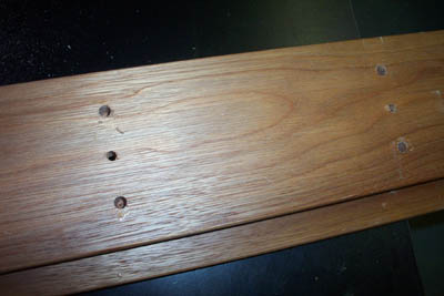

That's for real because I do not know the answer, it was sold to me as
"Goldwood", and gold it is in color, a deep yellow darker than in the pic. I
took my chances, I realy like the way it looks in spite (or because of) the
defects. It's also very light and stiff. Any idea, botanic name, place of origin?
Laurent Brondel
West Paris, Maine - USA

Looks a little like a girl I knew, Lu Ann.
Luan is a type of mahogany. Got a set of sides?

Luan is most emphatically not a 'type of mahogany', although it's often mislabled Phillipine mahogany. It bears a very vague resemblance to it (well, some of it), but I don't believe it's even in the same family as the Swetinias and the African Mahoganies (Khaya, Sipo, Sapele).
Meranti and/or Luan is kind of a collective name for various Shorea species. Kinda splinters easily, not the strongest of woods, but is used quite extensively in cheap asian guitars (emphasis on CHEAP). I'm not wild about the stuff, never met a piece at a lumber yard that made me go 'yeah, go on, try me out'.

laurent, my research books list two spieces traded under the name "Gold Wood" Common name Vinhatico, species Plathymenia reticula from Tropical America. Also called Brazilian or Yellow mahogany., Orange yellow, variegated streaks, fairly light weight, soft, tough and strong for it's weight. Stable. Species Enterolbium ellipticum or Pithecolobium vinhatico. Common names Gold Wood, Tatare and Yellow Wood. yellow to bright orange, variegated, lustrous, smooth, darkens with exposure...Google might show something up under these names.
Mattia, "Phillipine mahogany" is an accurate trade name that's been used for at least a century. The name is used the same way (of course) that African Rosewood and Bolivian rosewood are used, but are not rosewoods. Lauan shouldn't be confused with all Meranties. Some red meranties are very dense, strong and beautifully ribbon striped. Think Cris-Craft boats of old days. I've sourced some red meratnti for owners restoring some of these old glorious crafts.

Larry: I was under the impression that Luan was one of the Shoreas, like Meranti, and that various different species are often labled the same, although there are pretty significant differences between them. I regularly see 'meranti' plywood here that looks quite a bit like the above. Might be slightly different usage in different bits of the world. I know 'Phillipine Mahogany' is a well-used trade name, but that doesn't mean I like it, or that it's much of a mahogany, which was what I was (clumsily) trying to say. I also don't like calling Bubinga 'African Rosewood', f'rinstance
Bruce: I was only pointing out that Phillipine Mahogany and/or Luan ain't a mahogany, so if you want a mahogany, y'know, look elsewhere. I really have no clue as to what it is, but it might well be your highschool friend Lu Ann. Or possibly one of her sisters.

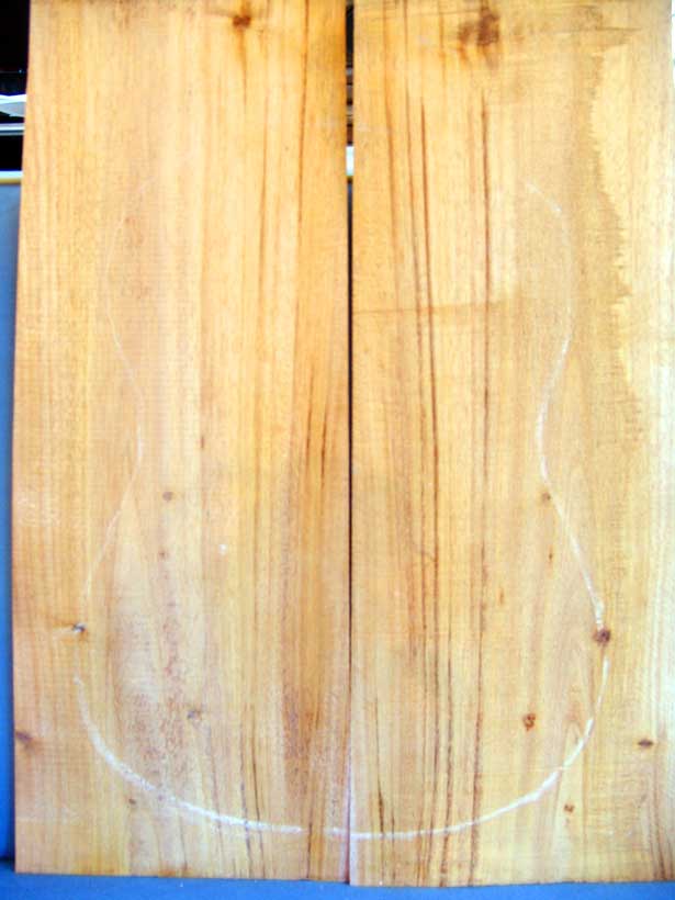

Here's a pic of what some of you identified as being Meranti if it could help differentiate with Laurent's wood, but though being aware that meranti seems to belong to a wide family, this one is from Indonesia.Hope it helps

Well, Laurent, the picture isn't that great (and please take no offense, it looks somewhat like a pic I could have taken), thus it's a bit difficult to see the details. I'll take a wild guess though: looks a bit like Canarywood to me. At least from here in Texas.
SK
PostPosted: Sat Jan 21, 2006 3:40 pm
That's what it looks like from Arkansas, too. Of course, that picture of Serge's wood looks like some red oak that I have.
